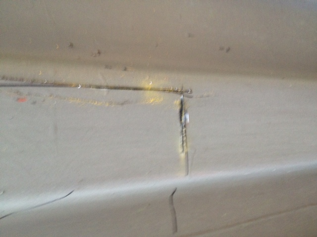

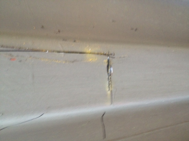

Begin by drawing out the area of the vent with a black magic marker on to the container. I used the flange for the gable vent as my template.
So you will end up with rectangle drawing. Begin at the bottom left corner and using the angle grinder, cut a horizontal cut following the black magic marker line. Your aim with the angle grinder is simply STARTING THE CUT, not cutting the whole thing with the angle grinder. Next making a VERTICAL cut with the angle grinder that starts at the vertical cut in the corner and goes up. Again, you only need a bit to get started. Go to the opposite corner of your marked out rectangle- the top right corner and cut a horizontal cut to the left and a vertical cut down.

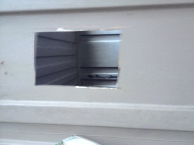

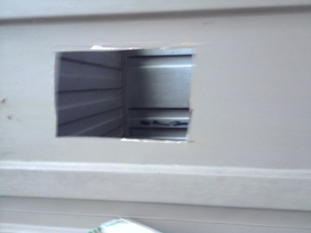

Now set the angle grinder down and pick up the reciprocating saw. The angle grinder cut you made now allows you to insert the blade from the reciprocating saw. This allows you to follow the lines and cut out the entire piece.
Fit whatever vent you choose in place and secure it. Be sure to caulk the hades out of it also, inside and out. Any security apparatus for the outside can be placed now or later- will not be shown in photos sorry.

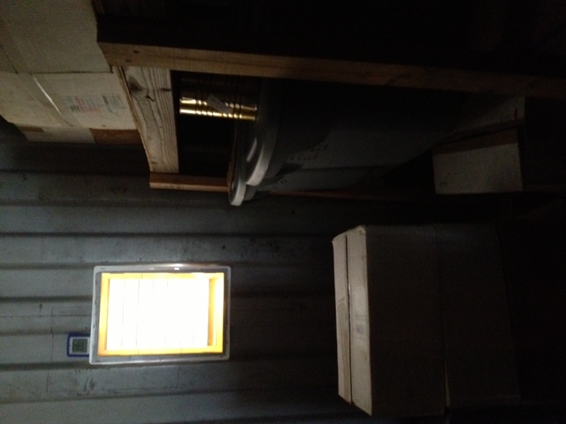

Here's how one of the gable vents looks from the inside-
Pic is pre- crazy week of carrying out, cleaning, painting and re arranging...So yes it looks messy in there ;0

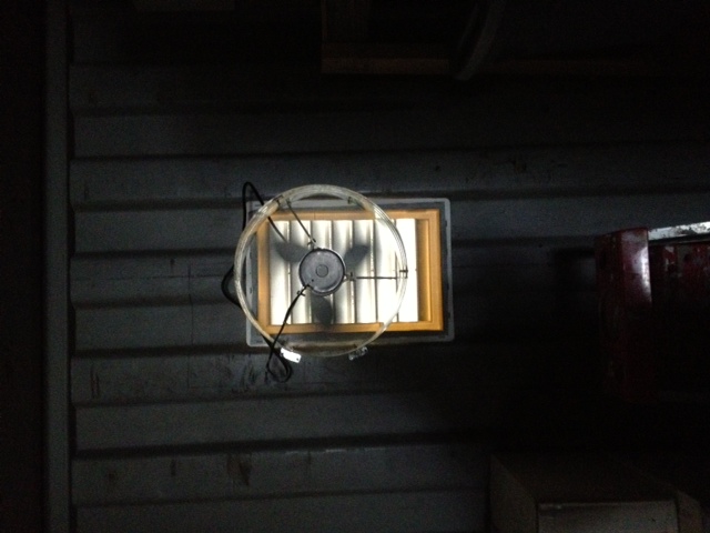

Now also, you can add a solar gable vent fan.
Depending on the type of gable vent and the mounting apparatus, you can bolt this right to the container.On the first install on the other container I built a wood rack to hold the fan. I will at some point re-do that and attach it similar to above. The wire for the panel is snaked through the vent and the panel placed on the best location within reach on the top of the container that gets the most sun.
When it's even remotely sunny out, that thing goes like mad. While the other fan with the 10 watt panel located very similarly doesn't even start up till late morning, this one is chugging away almost immediately once the sun is up and goes way longer into the evening than the other one. The panel being twice the size of the other certainly has a lot to do with it.
