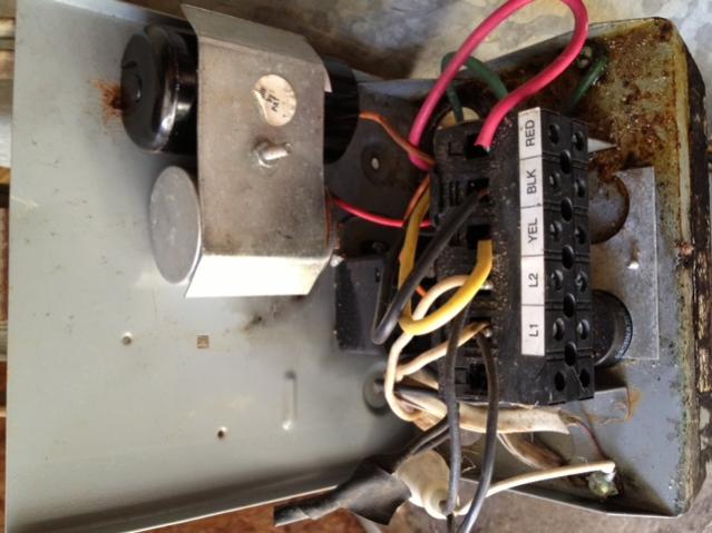

    This is what I see when I take the front cover off the controller box.
    Not good. Look closely at how it looks like something exploded in there- it did. Not sure how good you can see it in the pic but the black capacitor is blown, the silver one also, although less noticeable. There is a connection with a white tube that was blown out also.

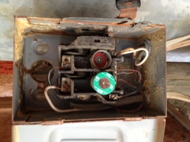

    Check power in at the top of the knife switch
    Yes, old as the hills knife switch, again this was already on the property when I purchased, it's since been changed out to something a little newer.
    So I switch the fuses out in the knife ("not a duck! A knife!" Anyone??) switch. Power shows good in to the top of the switch now. Here goes everything.... Throws the switch.
    Notice a small electrical arc across one of the fuses. Hmmm. That's never happened before. Turn switch off. Caps still look good, don't think anything blew there... Replace fuse, throw switch again. Same deal- arc and slight flash.

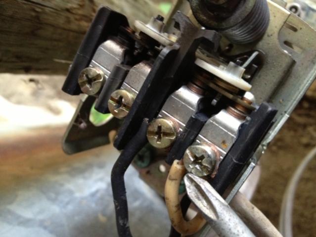

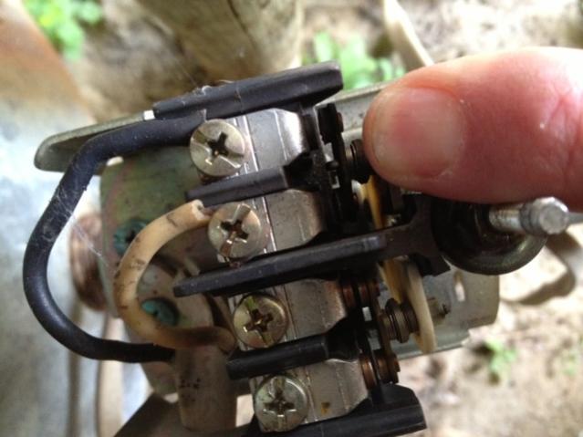

    Here is a pressure switch, it's designed to shut the pump off when the pressure in the tank reaches a certain amount-
    Now in proper condition this switch will cycle potentially hundreds of times every day. This is one of the parts I've had to switch out more than any others. You'll want about 3-5 of these in your well repair box- better yet AMMO CAN.
    If you can zoom in on the pic it will show slightly blackened on the contacts, I'm trying to hold the camera and point to that in the pic.

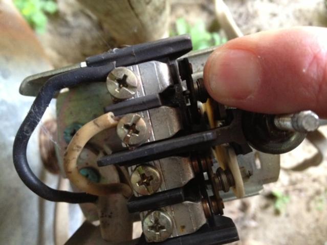

    Now this particular switch can be used in a 110 setup or in a 220 setup and they told me years ago that if your using it for 110 you can just flip flop the wires to the other side if the one goes out or you think it's gone out. Since I was pretty sure the pressure switch was working properly but just wanted to rule it out, I switched the wiring to the opposite side.

      Fried controller box with busted caps-

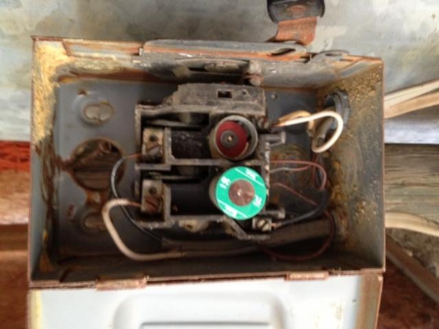

      Popped fuses on old knife switch-
      Pic noting blackened contacts on pressure switch-
      Pic showing switch over to other "leg" of pressure switch

              My pressure switch looks just like that but I can't switch to 120v my pump is 220v.

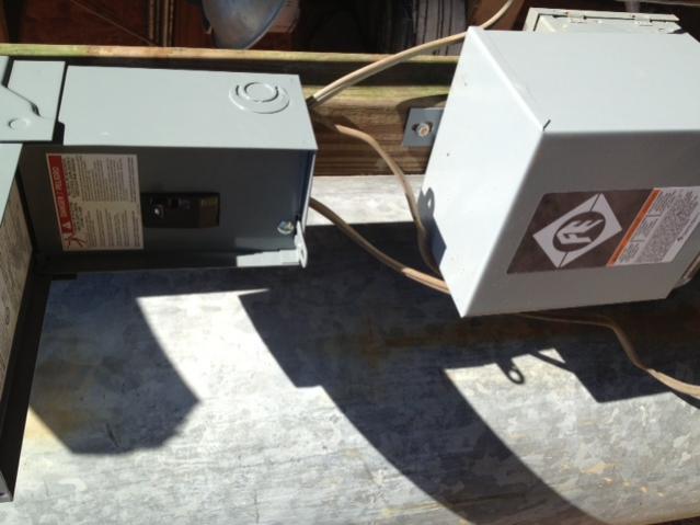

                  Here's part of the new setup
