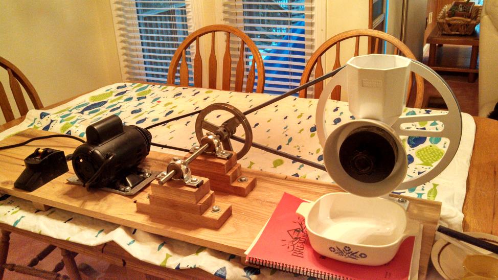

    I've been bored lately so I decided to motorize my Wondermill hand grinder. Here are a few pics:

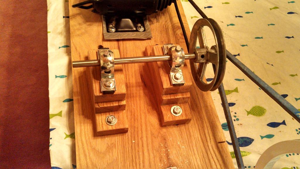

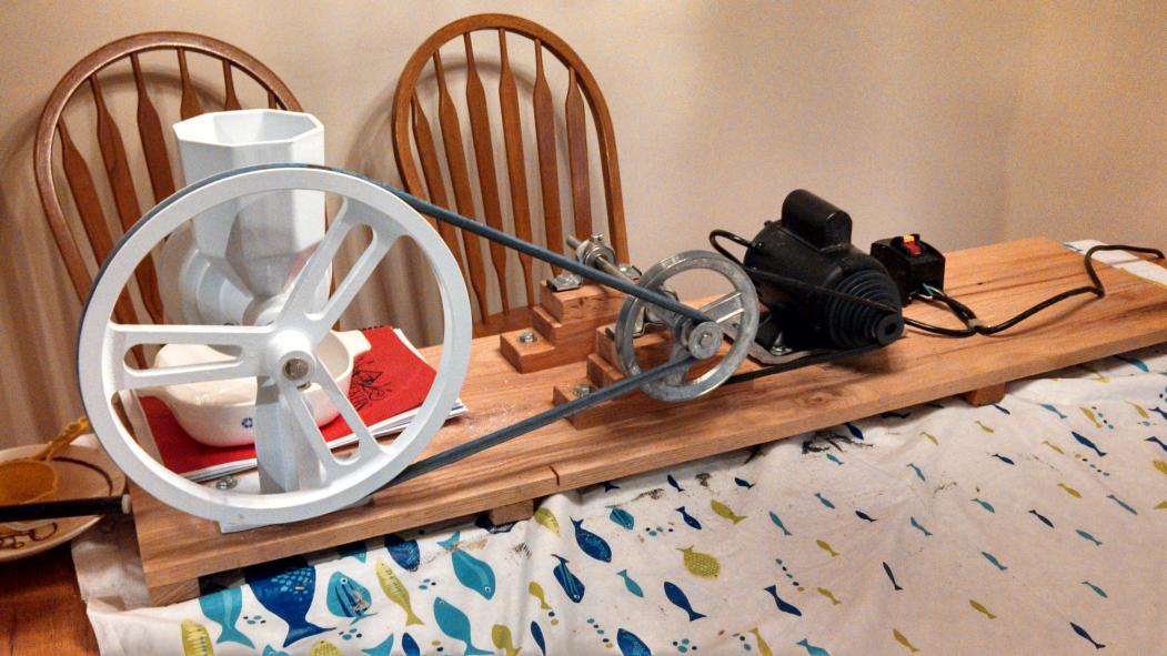

    The motor/pulley is off a broken drill press. The oak for the platform and bearing mounts are from my reject/scrap pile. The intermediate pulley shaft is 1/2 inch drill stock cut to length. The intermediate pulleys are from Tractor Supply Co. and the pocket bearings for the shaft are from Graingers. Total out of pocket cost is about $60 not including the grinder of course.
    The motor spins at 1750 rpm. The step-down to the first pulley is 4 to 1 and from the shaft to the grinder is 10 to 1, giving me a total step-down of 40 to 1 or 43.75 rpm. Wondermill recommends a max grinding speed of 80rpm so I'm well within the limits.

    Try to fabricate some belt guards... That is a lot of open pulleys in an area where your hands, arms and clothing will be near...
    Other than that, looks great! Well done...
      Yep, the belt guards are on my list. I picked up the parts last week and glued/sanded/stained the wood last weekend. Put it together in my free time while working from home this week during the ice storm. I have to pick up some sheet metal for the guards.
      Thanks for the complement :D
        It looks really nice...knowing how to calculate the pulley's is something I don't know...but I am sure google could help me.
          It's easy. The first pulley is 1.5 inches, the second is 6 inches...6 / 1.5 = 4. I verified when I got them hooked up. Second pulley i1 1.5 and the one on the grinder is 15. 15 / 1.5 = 10. Again, verified when it was hooked up.
