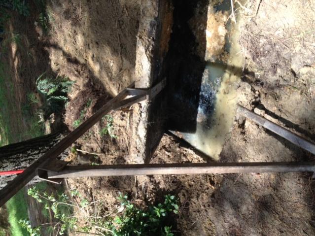

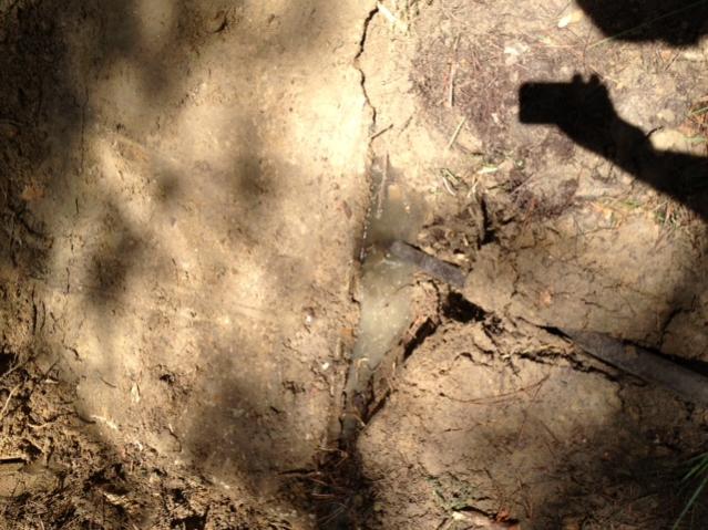

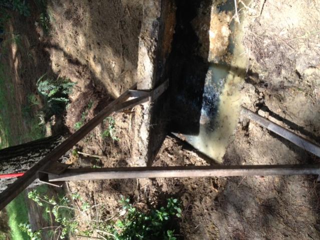

    Upon digging around the cover of the tank you might see something like this-
    Not good...
    Note the liquid coming out after the tank lid was levered up just a bit.
    Here's a few notes from this-
    After you locate the tank top, you need to figure out what KIND of top it is. In this case this one of ours is the old school solid concrete one where it can be split into three sections. Usually one section is leveraged up and slid out of the way, then the cleaning guy can pump it.
    Newer ones have a 24" or so round cleanout in the top of the tank. Usually this is a concrete plug with a handle, then often times a plastic top covering that. That type CAN be easier for the tank cleaning crew NOW. But I wonder in the PAW having to use "various methods" to pump the tank would the 24" cleanout be a good thing or bad thing? Seriously, you may have to get access to get into the thing with buckets (Got Prisoners? LOL), some sort of homemade pumping apparatus, etc.
    How to open-
    I've heard the tool called a "railroad wrecking bar" but the people that I work with tend to call things different than what others in the free world call them :) It's basically a massive metal rod with an angled end on it. Think a giant crow bar that's straight instead of crooked. It's long for leverage and levering all sorts of things with them, I've never seen one break. I suppose you could do it with a couple crow bars also but it would be more of a PITA. I could see where some wedges would be really handy as well.
    A little yanking on the top, once all the dirt is removed from the top and edges, usually breaks the "seal" of the tank top. Here's where the fun begins- don't fall in ;)
    If you have a wedge, use it. Tank lid is beau coup heavy, even if it's just a third.
    Now here's the cool thing-
    What to do with the third of the lid? If you cleaned off all the tank lid you can sometimes slide part of the top over on the other part. Which brings up an important point- WHICH part of the top to open? If it's one of the old break in thirds deal- take the piece closest to the INTAKE off. Why? Cause sometimes it might be something stupid like just the intake is clogged- you might be able to clear it without having to pump the tank.

    OK, so back to the problem at hand- you got the lid cracked, you have it wedged, now what? Check this out-

    This device was similar to a log roller/peavy that holds the log up after gripping it so you don't cut into the ground. Notice the little kickstand deal and the part that's attached to the lid is simply a two pronged fork. As the lid is lifted the kickstand comes from and holds it in place. Quite cool.

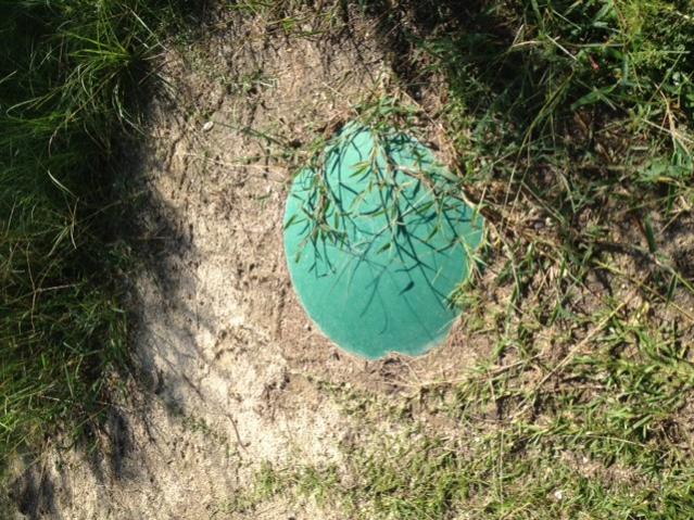

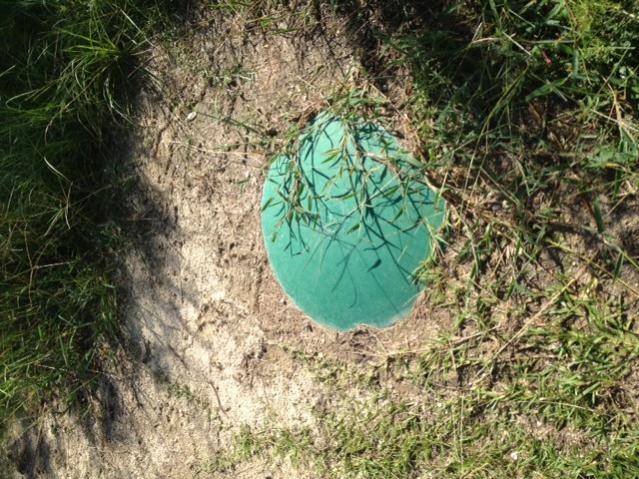

          This is the other type of lid I mentioned in the OP. Approximately 2 feet circular concrete "plug" with a handle on it with a plastic flange that the plastic lid fits into set into the concrete.
          This newer style has two "chambers" with a little opening between the two. The idea being that solids never make it past the first chamber and that liquids move through the little opening and when the level is high enough, they go out to the distribution box, then to the drain field. Provided of course it all slopes that way. Remember the cardinal rule- Poop runs down hill!
          I have assume this newer type would be harder to pump/clean under primitive post PAW methods. The 24" opening will require a skinny prisoner and potentially smaller buckets. Borrow your neighbor's ladder or lower prisoner in on rope. :)
          Seriously though, I have to assume this type would require more running water, since the solids and liquids are separated more introduction of running water into the solids chamber and more breaking up via the big long iron pipe/tee combination previously mentioned, would probably be necessary. In short probably more work cleaning a two chamber one with post PAW primitive methods than a single chamber old skewl type one like in the previous pics.
