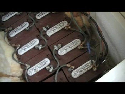

Here is that inverter and an inexpensive system we put in at our hunting camp years ago-
