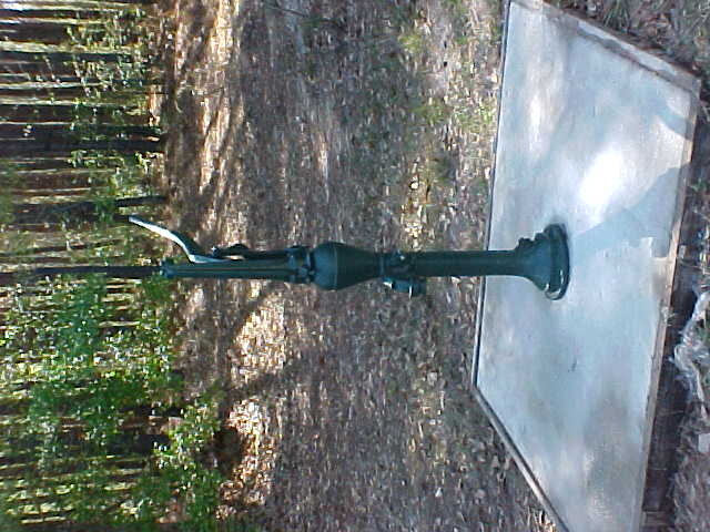

    A year or so back, my BIL in South Khakilackee who works for a well drilling company was slow on work. He was coming to visit for a while and he was able to convince his company to let him take his work truck over here in return for us buying a well from them. Worked out great for all involved.
    We ended up with a hand pumped deep well setup out of his visit and learned a little bit about wells.

    Anywhoo, this one DOES work. Not sure how much of a "deal" we got on it via "family prices" or not but it was around $3,600. with a 250 foot well into the aquifier and the pump installed. A chunk of change, without a doubt but worth it IMO.
    Water has always been our most fragile system in our infrastructure. While this won't do much for our day to day normal operation, it could be our sole source of water in a worst case EMP/TEOTWAWKI type deal. The genset will run the other deep well and storage tanks will give us some pressure and that's how we "roll" normally ;) But this requires some power- genset. And while you can have logistics planned and squared away for that, stuff does happen.

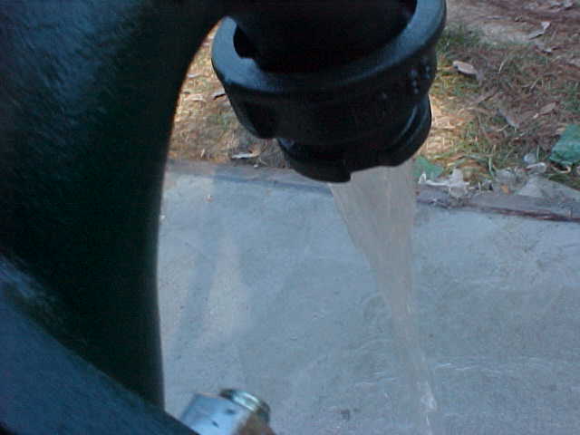

    This pump doesn't seem like it puts out a lot and even my BIL said "I don't think it's putting out enough." But I went and got a 5 gallon bucket and really started working it.
    Let me tell you what- you want a workout, try to fill a 5 gallon bucket with this as fast as you can. With my son timing me I got a 5 gallon bucket out in 1 minute 35 seconds. It didn't kill me, but my breath and pulse rate was definitely up by the end of it. In contrast our normal irrigation system fills a 5 gallon bucket only about 20 seconds faster (with sprinklers going).

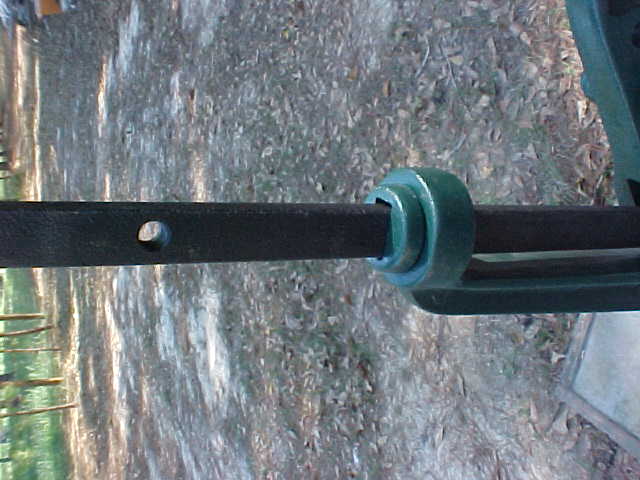

    I don't know if it will be able to be seen in the pics, but my BIL showed me a hole drilled in the huge bar that goes up and down as you pump- "this is for attaching to a windmill" he said. Cool! Never knew you could do that.
    That would definitely be the way to go, and he said he has installed similar setups with windmills for cattle ranchers to fill water tanks in the field for their cows.
    The pump itself is tough as nails, stands well over 4 foot tall and weighs a good bit. I was told that their is one part below the pump that can break but in 10 years of well and pump work, he's never seen one break, not even the regular use ones.
