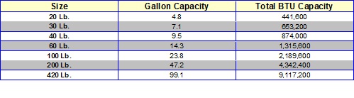

            Cylinder Capacities in Gallons and BTU's
Name:	lp cylinder.jpg
            Using these factors we can arrive at run times based on average load for any generator. For instance:
            How long would a 5000 Watt Generator with a 10 HP engine at 50% load run on a 20# propane cylinder?
            10 HP at 50% load would be using 5 horse power to generate 2500 watts of energy.
            5hp x 10,000 BTU would consume 50,000 BTU per hour.
            Using a 20# cylinder that produces 441,600 total BTU, the engine consuming 50,000 BTU per hour would run for about 8.8 hours.

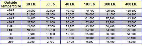

            Many people want to know what size cylinders they need based on their engine size. Here are some real conservative estimates of the vaporization rate of various size cylinders based on the outside temperature.
            Vaporization Rates of Cylinders
            Output in BTU's per hour - Vertical Cylinder 25% full - Minimum Cylinder Pressure 10 PSI
Name:	vaporization rates.jpg
            For the physical properties of each cylinder, click on the "Cylinder Size" above.
            What does all this mean?
            Well, if you went exactly by the chart, you would need a 420 Lb. cylinder to run a 14 HP engine if it was 25% full and 40 degrees outside and keep a minimum of 10 psi in the cylinder. This is a worse case scenario. For instance, when a 20 Lb. cylinder is full it can run a 16 HP engine for quite some time in 40 degree weather before there will be any freezing problem. But if you wanted to use up all the gas in a cylinder, it would have to be sized according to the chart.
