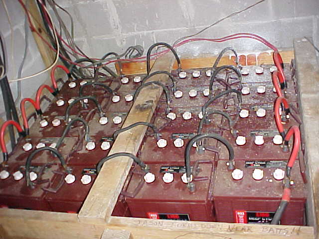

                            Ugly picture here, but you can kinda see how this 24 VOLT system battery bank was wired up.

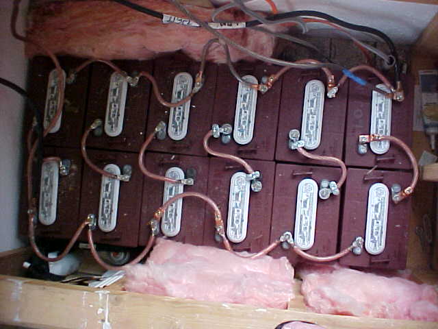

                              Another ugly picture- this one is a 12 VOLT battery bank at our hunting club. if you had less batteries the wiring would be essentially the same, it would just vary where you connected your pos and neg from the charge controller and to the inverter.
                              Sometimes pictures help, at least with me :)
