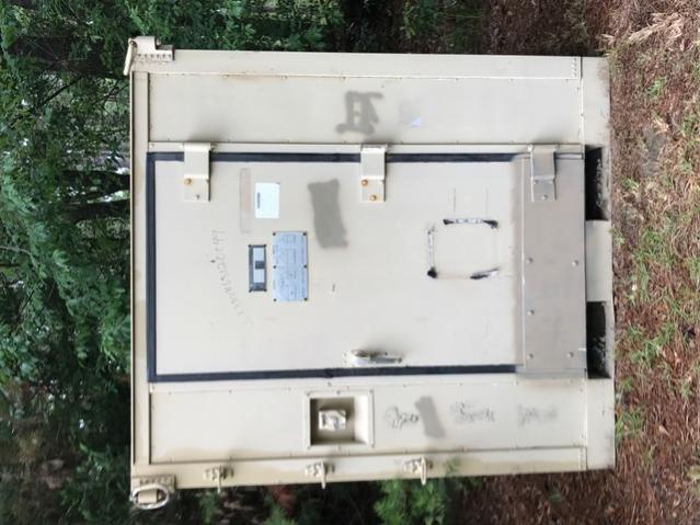

    Got this little container a while back at an auction about an hour away.
    It's one of those deals designed to go on a large truck bed. Good seal on the door, lighter metal body. I walked on the roof recently and it seemed as tough as the 40' sealand container roofs.

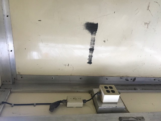

    A view of the interior-
    The shelves are removable, but I will likely leave them in place.
    There is a light and an outlet. Not sure at this point if they work or not, but given the condition I assume they will.

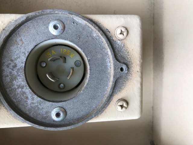

    Has an odd plug on the outside to connect power, I'm not familiar with this, but then again I don't claim to be an electrician and I didn't stay at Holiday Inn last night...

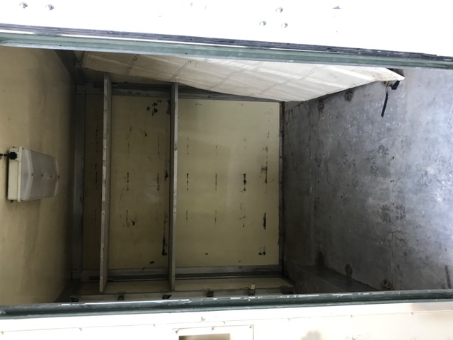

    Here is the left side-
    This is the side I will likely build a bench for comm gear. The outlets are right there so it might cut down on cords running here and there on the floor.
    There are perforations that I'm aware on in this, and before I make one I need to be sure where I'm going to put everything, future needs, etc. This will NOT be a living space. The comms bench will only take up the wall on the left side (probably not all of that). The right side I'm considering building another bench platform against the wall there and use that for general work on firearms. Put all my cleaning gear, armorer's tools, most spare parts, etc. there. Maybe finally get one of those neat little holders for the rifles so you can clean it while it's being held instead of on your lap in front of the TV lol.

            It's a twist lock style like you'll see on some gennys, and RVs.
            Your limited to 15amps. Possible wire it as a back up vs primary. Via sub panels.
            Power goes out you plug into gen or AE..to power necessities.

              So I can probably find a similar plug at Lowes and run 12-2 from the inverter to it?

                    Yes they should have that plug. 12/2 will handle 120/15 no issues.iirc its like 30 max..but I've never done it to accede 20.what you could do is put a quick disconnect at the one end. And just hard wire it. That way it's flip of a switch.
