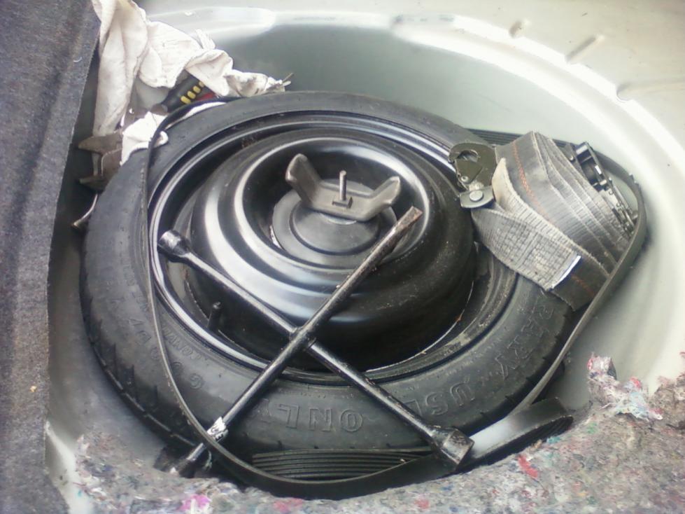

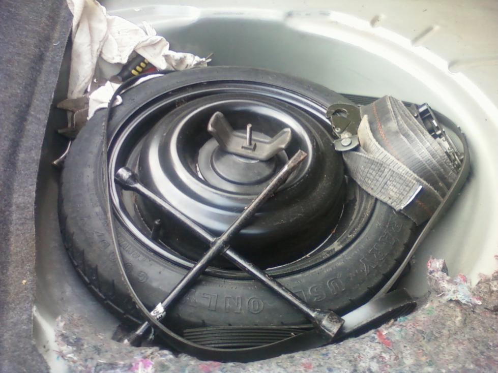

                          My Daughters car started to shred one today so we took the opportunity to video on a cell phone. We spent more time at the parts counter than fixing it. The age was an unknown on this belt but I suspect the cause. The old belt will be trimmed on the shreded material and placed in the trunk around the spare tire taking up no extra room.
Name:	Serpantine Belt around Spare Tire.jpg
                            Awesome Matt! You've inspired me to go ahead and change the belts in a couple of my vehicles. I'll keep the old ones as spares.
                              Old ones are spares.
