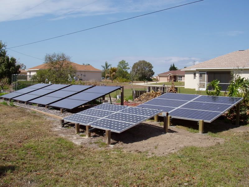

                Takari - can you post pictures of your system. I'd love to see your set up.
                The arrays
                The system
                Now I have this itch to put a tracker behind the big array with another 4 panels. I was thinking of putting the big array on a tracker but that thing would be too big. My wife doesn't want more on the roof.

                        1) Large array: 12 BPSX3200 200 watt panels wired 3 strings of 4 panels
                        Outback combiner box and midnite solar 10 amp breakers.
                        4 awg cable from array to charge controller in garage. Approx 70'
                        Delta lightning arrestor in combiner box. Does it really work? I hope it is never tested.
                        Small array: 2 BP 585 and 4 BP 590 panels wired one series string.
                        Medium array: 6 BPSX175 NQ panels wired 2 strings of three into the same combiner as the small array.
                        Mixing panels this way only works correctly as long as the specs of the strings are as close to identical as possible.
                        One string of the BPSX175 panels has almost the exact same output in amps and volts as the string of the 590/585 panels.
                        8 awg cable from arrays to garage charge controller.
                        Total wattage all together 3980.

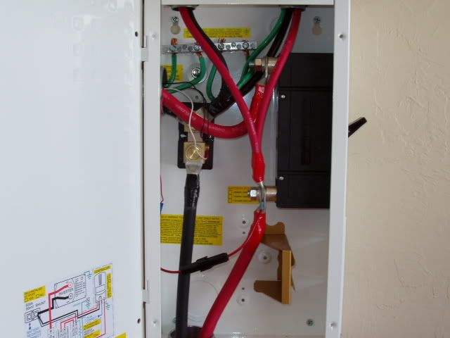

                        Inverter SMA Sunny Island 5048u. 5000 watts 48v. It can be overloaded for a short while without shutting down: 6500 watts 30min, 7200 watts 5min, 8400 watts 1min, but the step up transformer is only rated for 6000 watts.

                        Midnite solar mini dc disconnect w/ 250 amp breaker.
                        This is where the batteries, charge controllers, and inverter are all connected.

                        6) Placed my arrays a little more strategically. Used ground mounts that can be adjusted up or down with the change in seasons to get the most output.

                              We have our original 14 KC130's on a fixed rack. 6 more on a track rack (see pic at top of forum) and 4 more KC130's on a fixed rack on a side roof of an outbuilding that houses my battery bank, inverter, etc.
                              Our track rack actually sat unused (long story) for about a decade. It was interesting "yard art" to most people. It had rusted in several spots, both of the shock absorbers had rusted through, it was a mess. I started working on it, found a couple of similar shocks, ordered some new clips, etc and it worked fine.
                              The catalogs make it out like it makes small movements throughout the day. Maybe mine would have originally, but now it just makes one sudden move in the morning back to face east and one early afternoon to face west.
                              I'm not very scientific on my numbers, etc. Honestly I don't watch the input very closely. However since the time we put in the six on the track rack, we haven't even come close to running out of power. Wherein previously in the wintertime I would usually have to run the genset for a little while in the morning.
