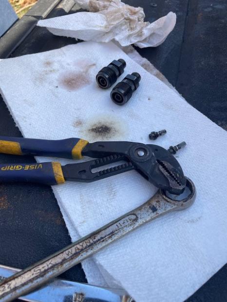

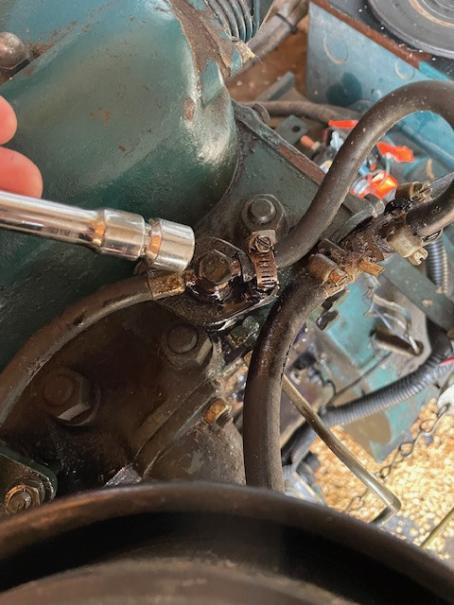

      Had a little more time to mess with it. Worked on the Murphy switch a bit and got it going. Generator will now attempt to start via the Murphy switch which is how it always has.
      I cracked the nut on the 2 cylinders and I'm getting fuel out of them also-
      So I've bled every damn line I can see and everywhere I can see fuel can go, there is fuel. Yet it will not fire up. Whiskey Tango Foxtrot over! Even the return line (last thing in line in that pic to the right of the injector head will spew fuel when the clamp is released. Not even hearing big air hisses or rushes of air when any of these are cracked to bleed the lines.
      Going to follow up with some diesel experts more this week.

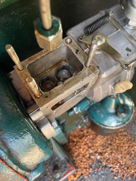

                  Had a guy over to help and we opened up the new pump today-
                  What was interesting was with the top part off, when we pushed down on the springs they were extremely tight- stuck basically. You can see in the middle pic inside of it the little black circles are like lifters (don't know the correct mechanical term) that basically push up and force the fuel through the pump to the top pieces (first pic) where it then goes up the metal lines to the cylinders. We had to work those a bit to get them to move at all. My diesel guy took the unit apart and tried everything. My original pump is with another guy that is testing it. I think between the two of them we should be able to get something going, but it would appear like the New one (in pics) is not working correctly. To quote the guy today- "this is a simple 2 cylinder engine, this should be pumping."

                            It's definitely the fuel pump. A guy has both of the fuel pumps now.
                            He came out a few weeks ago, went through all the normal stuff that we have done six million times now and mentioned looking at the fuel pump. The old one was off and so I sent him back with that one.
                            One of my normal guys that helps with the heavy equipment came next week, he took the new one apart and it was locked stiff. We messed with it about four hours.
                            The guy that took the first one called me last weekend and I went to his shop. He showed me how one of the little rods where the fuel actually pumps up or through was working smoothly and the other was not. Like it was either just a smidge off spec or bent a bit in the slightest way- and you cannot see this if it's a small bend. Keep in mind that's the original pump, which worked well for years, so I doubt it was out of spec to begin with. He said he had been polishing the one and it had gotten better but ideally it would need replacement. I told him- well I have a non working brand new one just in from Chyna. Brought it to him the other day and told him use whatever the hell you need to from both of them to get one working. Should be a couple days.
                            I got the Muprhy switch working myself after tinkering with it for a while. I have previously replaced the solenoid, there is also a solenoid on the starter and that and the starter was tested at an electric shop and found to be fine.
                            One of the things we did was get the unit firing with ether and a small amount of diesel in the air cleaner and it ran for 10 seconds or so like it should.
