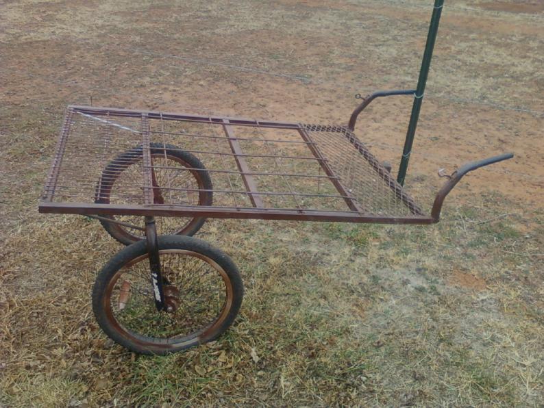

    One of the ideas recently was to use a deer cart to move water. This is a good idea as they are designed for weight and rough terrain. My son and I built our own several years ago. We hunt public where no 4 wheelers are allowed and dragging the deer over the loose shale on hills leaves alot to be desired. It' s very abrasive on the animal. Some of the swamps I hunt and the plains buffaloe grass makes movement with an animal difficult. We decided to get a cart and after looking at the prices we were not going to be able too as season was rapidly approaching.
    We decided to build one. I had some pieces of 1x steel tubing, some left over expanded metal, hog panel and an old refridgerator rack and my sons old bicycle. It took my small wire feed welder and a recipocating saw. No other tools were really needed. We used a few leftover cans of spray paint to keep the rusting down. We did use a grinder to smooth out the edges.
    The only money we put in it was 2 ratchet straps and 2 solid tire tubes. They are worth the money in sticker country. I have rountinely moved 2 deer at a time with backpacks on this. We broke a weld once dropping it down a ravine to get where we were going. Easily fixed. We JB Weld(ed) it at deer camp and it held till we got home.
    We have under $30 in this project and have used it for 5yrs now.
    The point I'm trying to make on this post is that a lot of the time as "survivalist" we become to caught up in the consumerism. Skills, know how and ideas are what will pull you thru. Post SHTF we will have to rebuild, we will have to build as needs expand and in every day life we need things. If you put looks aside and go for practicality you may find you even build a better product than the chinese!

                Just a question. Why not use 4 wheels?
                  I assume the need for additional engineering (swiveling wheels) and weight (4 wheels with hardware)...
                  The only thing I would change for MY AREA is make it narrower so it could fit on hiking trails and wooded paths... Maybe center the wheels so that the wheels carry the weight like a balanced see-saw rather than like a wheelbarrow. That way, my work would be mainly balancing it and pushing/pulling it, rather than lifting weight as well.
                  If one had to bug out long term (more stuff), without security concerns (evacuation), with no ability to use a vehicle, these carts would be a life saver...
                    there are pros and cons for 2 wheel vs 4 wheel...
                    2 wheel has simplicity in design
                    2 wheel has lower construction cost
                    2 wheel design is usually lighter (less for you to have to exert to push-pull)
                    4 wheel has higher cost
                    4 wheel has better balance issues (not requiring you to lift, only push-pull)
                    4 wheel more complex to design
                    4 wheel requires a brake (SHTF while moving, you drop to the prone, and without a break, your cart keeps rolling, bad bad mojo)
                    and remember, think OUTSIDE THE BOX, why not 3 wheel? 3rd wheel being the rear wheel, NEVER the front wheel...
                    all being said, i would actually go with a 4 wheel if i was preplanning, and most likely a 2 wheel if it was a "need it now" kind of item :)
                    hope this helps
                      I only had one bike :) LOL
                      naw seriously for water and stores 4 wheels might be ok but for deer in the rougher terrain 2 wheels and I only had one bike LOL
